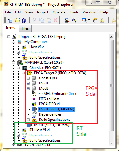

Hello
You could use this USB Instrument Driver Control White paper to add the joystick as a USB VISA resource. After that, it’s just VISA calls to read the data from the joystick and send then, like Chris said, send the values from the RT side to the FPGA target side.
Remember your Real-Time Target has a Real-Time side (RT) and an FPGA side. Since the FPGA side doesn’t support that resource, you need to use the RT side.
Once you have your VISA resource added in MAX, you can use a shipping example like “Basic Serial Write and Read.vi” (Help » Find Examples » Search » “visa”) and put the VISA Read in a loop to continuously acquire the data from the USB. You can then send it to the FPGA. You can learn more about Transferring Data between the FPGA and the Host (FPGA Module) in this link.
