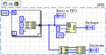

On your FPGA application you are reading three channels at once and feeding them in one at a time to your FIFO, which is exactly what you are supposed to be doing. What you should be doing on the RT side is taking the elements you read from your FIFO and feeding them into a Decimate 1D Array. I think you are trying to do this but that the reshape array function isn't doing what you think it's doing. In the snippet below, I show how you are displaying the data and what I think you want to be doing. Additionally, I would make sure to break up the FIFO into the three original channels before doing anything with the data.

What I wanted is to gather voltage reading from the transducer and put them in one file for later analysis, it would be a 3 column file with x,y,z axis voltage data for according force values. That is why I displayed and recorded the data together.
Is there any benefit of breaking up the FIFO read data? I was thinking maybe the channels are influencing each other (because the other two unassigned channels kind of follow the assigned channel), is that why you are telling me to seperate them?
