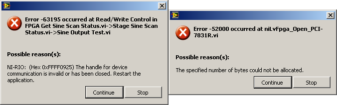

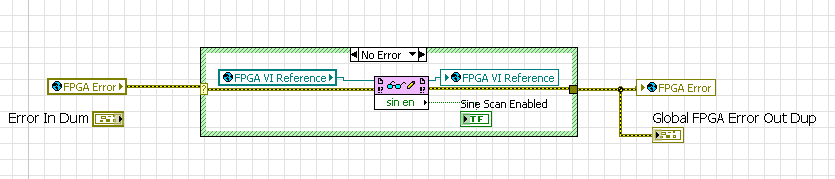

I'm also having the same error on a PCI-7831R on LabView 2010 which seems to originate here:
This code is being called  approx. 10 times/s and after a couple of minutes it throws either -63195 (The handle ... has been closed) or -52000 (The specified number of bytes could not be allocated) the latter happening more often:
There are many more locations in the code which do a similar read, but only this particular one throws this error.
Automatically Close VISA Sessions is unchecked and cleanupVisa=False is set. Otherwise LabView is running fine, no recent updates or anything. The given code was throwing errors like these right from when it was written as far as I can tell.
