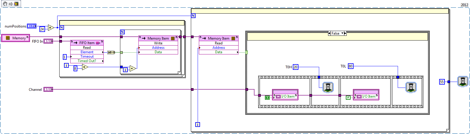

I need to write code that produces a pulse train/PWM with a variable duty cycle per pulse; This feeds to a serial line on a chip that reads a bit as high when the duty cycle is 80%, and low when it's 52%.  So the good part is that it's not infitely variable.
The code I came up with is attached; however, this code (along with the code that calls it), requires well over 125% of the FPGA.
I have narrowed the problem area down to the case that passes the tick counts.  (If I replace the CASE with just static constants, the utilization is around 20%.  I have also tried the Select node from the Comparison palette, and encasing the entire pulse generation code structure in a CASE, with the same results.  Any time the delays are not constant, I go way over.

I suspect that the nested FOR loops are part of the problem, and possibly the reuse of the same IO channel if you have enabled arbitration for that IO channel. Have you considered whether you can rewrite this as one single-cycle timed loop? If you need help with that, post actual code instead of an image and I'll take a shot at reworking it.

The IO channel is set to never arbitrate, and there doesn't seem to be any problem with the IO; all I have to do is eliminate the CASE on the timing integers (which feed the delays), and it compiles perfectly well.
I have done plenty of input and data storage with these units, but never set up anything more than simple PWMs.  This is a weird thing for me to see.

I don't know how that LabVIEW code is being converted to hardware, but there is a possibility that what you're creating here is a relatively large 160x8 lookup table entirely within FPGA logic, which is not very efficient. Since the arrays are fixed-size (and constant in your image, although maybe that's not the case in real code) the compiler can precompute the case structure outputs for every single for loop iteration and store them in a lookup table, so that when the code executes there's no evaluation, it's just a lookup of the two for loop indices. I do not have enough knowledge of FPGAs to know if that's likely to happen but it might explain what you're seeing. You could prove it by varying the number of iterations and see if that scales with FPGA utilization.

This latest version creates a HUGE lookup table, and so it fails miserably.
If I switch to a WHILE loop, will the compiler skip the LUT?

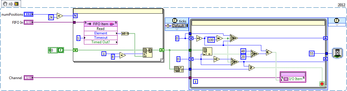

For unknown reasons I can't get this to compile (it starts the compile, it even tells me that it successfully completed estimating resource utilization - but then it doesn't show the results) and I don't have time to fight with it right now, but I would try something like the coe shown below, which replaces the for loop with a single-cycle timed loop.

Thinking about it more, the 8192-element boolean array might be the problem. Consider using a memory block instead. A large array like that isn't very efficient on FPGA, and the array might be the reason for the excessive lookup-table use.
Be careful about changing the FIFO data type if you care about throughput. I did some testing of U8 versus U32 and found that I could transfer the same number of elements per second for either data type, meaning in terms of throughput the U32 was 4x slower. If you change to bool, it will be 8x slower, although maybe that's acceptable in your application.
I recommend using a timeout of either -1, so you always get all data, or 0, in which case the loop speed stays consistent, but that's mostly my personal preference. A timeout of "1" does seem very arbitrary.
If you get a chance, see if it compiles, or at least can estimate resources, on your machine. The single-cycle loop should be a tiny amount of FPGA space, but again, the large boolean array is quite possibly the problem.

Looks like a memory block is the way to go if you want to reduce resources without rewriting. The code below fits easily and is only slightly different than your original.
