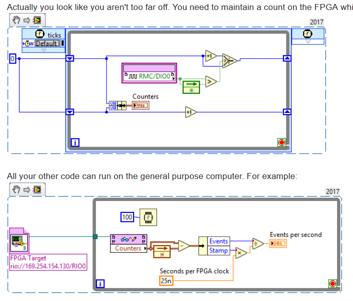

@Dhouston wrote:
nanocyte. Thanks for the link.  I see you use a SCTL, which looks a little like my Pulse Counter loop.  I didn't know if a SCTL would run too fast.  The counter needs to be in sync with the timer.  I thought of using a SCTL for the timer and the counter, but I don't know if both of those can go in a SCTL, and since we can't have more than one SCTL, I am at a standstill on how to handle this.
What does "run too fast" mean?
Why wouldn't timer and counter be able to go in the same loop? That's what I have in my code. The top +1 is the counter the bottom +1 is the timer (notice how the RT code subtracts two subsequent "stamps" and multiplies by 25 ns to get an accurate measure of how long it's been since the last count sample.
Why can't you have more than one SCTL? Nope, that's not a rule.
Message 16 of 28
(2,830 Views)

@Dhouston wrote:
Thanks for that, jg69.  Let me provide some information and answers to some of your questions and responses here:
Why not use nanocyte's suggested solution:
-Looking at it, nanocyte's solution works for counting (e.g. counting digital edges).  However, my issue is timing (like a stopwatch).  The Pulse Counter loop I have does count the pulses properly, although based on your statement listed below, I may redo it.
No need to start or stop your reading of your flow meter, it runs continously inside the FPGA, and inside your RT code, you'll calculate the Pulse Rate
-Ok, my issue here was that I vaguely remember running into the issue of a continuously running program (due to the FPGA loop never stopping), or an FPGA loop which started counting pulses immediately when in fact nothing was operating.
Why use a loop timer with waiting time = 0? It's also recommended to use the loop-timer express VI inside the first sequence of a flat sequence structure (read the help about why that's recommended).
-The loop timer with waiting time of 0 is to synchronize the loops as I found out the hard way that using this loop timer with different wait values causes problems.
Whoops, did nanocyte just post something while I was typing this?
Running continuously is not a problem because of the subtraction. Lets say it's been running and the count is a 1000 and then 100ms later it's 1100 that implies you have a rate of about 1 pulse per millisecond.
There are much much better ways to synchronize your loops. For example you could subsample the pulse count at the rate of the analog inputs by using a local:
You could also use a handshake to sync data
Message 18 of 28
(2,823 Views)
Hello nanocyte.  I'm glad you popped in since your solution seems to be the anchor point here.
In answer to your questions:
-I wondered if a SCTL would actually time faster than an actual stopwatch would since that is the type of timing mechanism I want to replicate.
- Ugh!  I think you are using some things I don't know about, nanocyte.  In your SCTL, is that a bundle function you are using to bundle the shift registers into the count?  Just what is that thing that is labeled "count"  in your SCTL?  It looks like a time stamp constant or something. Then comes my big question:  How are you able to stop these loops?  There is no control or anything wired to your loop stops.  When I do this, I get the eternally running program.
-What?  Really?  I thought I heard this very thing in the online FPGA course. Maybe I got that mixed up with all the things you can't have inside an SCTL.
Message 19 of 28
(2,820 Views)
Hello Dhouston
A SingleCyleTimedLoop will execute on every cylcle of the FPGA clock that you assign that SCTL to. The typical base clock rate for many NI FPGA products is 40 MHz, so all code that you put inside a SCTL will execute at a rate of 40 MHz (exeption: if the code takes to longer to execute as 25 ns, than you'll get an compile error and then you know, you have to change something in your FPGA code).
The number of executions of the SCTL is counted. As this takes 25ns, it is kind of a timer.
This programm is designed to run as long on the FPGA till you reset your FPGA resource or power down your cRIO. That's something typical for FPGA code. You want to run that indepently of your RT-code.
There are some limitations when using more than one SCTL, like sharing resources. But yes, you can have as many SCTL-loops in an FPGA code as you like - as long as the code compiles...
Regards, Jens
Kudos are welcome...
