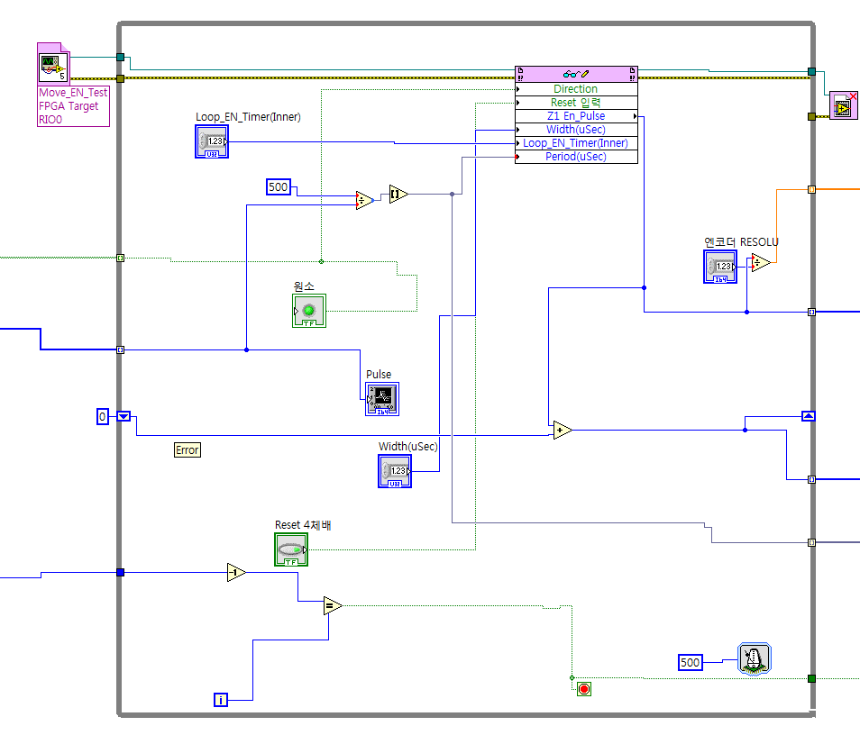

Hi All,
I was sure that two parallel while loops are independent.

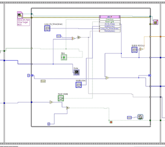

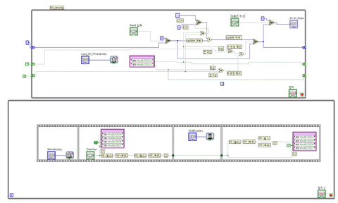

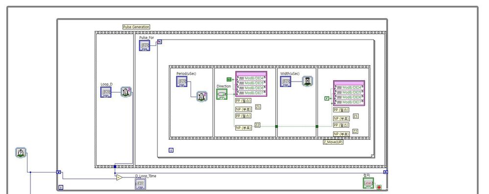

In my code, there is two parallel loops, One for pulse generation and another for getting the encoder values.
But, after implementation of this code, I'm not sure that parallel loops are independent. Am I right?

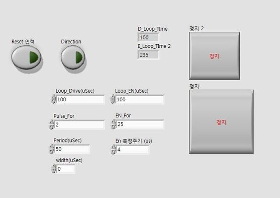

In below figure, there is two indicators: D_Loop_Time, E_Loop_Time2.
I fixed the control values for each loop timer 100us, but you can find the E_Loop_Time value is not 100us.
What is the problem of this code?
Please Help me... I'm in panic....:(

The loops are independent. It just appears that your second loop cannot execute that quickly.
You have at least 100us based on 25*4us waiting, and then also some digital I/O (probably quick, but depends on hardware how quick).
Additionally, this isn't a SCTL, so there are specific overheads for each loop iteration in terms of number of clock ticks (perhaps at 40MHz clock that adds a little bit... not much but still)
It appears a lot like you're overconstraining the loop times, and then somewhere an assumption isn't valid. For example, in the top loop, you have a 100us Loop Wait, combined with 2*50us waits inside the loop. This fits, but changing any of the values could make that false. The system is very brittle.

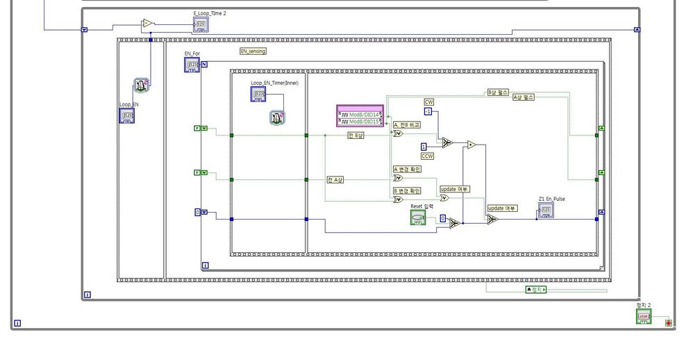

Thank you for quick reply.
I measured the Loop time to implement For Loop in bottom While Loop. It takes about 12us..
Your answer is correct. Thank you.
But, How can I decrease this loop time...?  I am new in Labview.. So I have no idea to do this..
Can you tell me some methods?

Well, looking at the icon via the image, you're using Wait Until Next (or the equivalent on FPGA)? This will coerce you up to a multiple of the target 4us, not finish as quickly as possible after 4us.
What are you trying to do here? You want 25 operations evenly spread across 100us? Or you want 25 operations every 100us, and the spacing is unimportant? Or some other arrangement?
On FPGA, using a Single Cycle Timed Loop is often a key part of making things happen quickly. The below is copied from the link:
How much faster will programs execute using the SCTL?
Using a traditional While Loop in your FPGA VI takes an absolute minimum of 3 ticks to execute each iteration. This is because of the enable chain used in the compiled FPGA VI. An explanation of the enable chain is beyond the scope of this document, but is used to ensure dataflow when the FPGA VI is compiled into a bitfile.
Additionally, each function inside the While Loop will require at least one tick to execute, although functions will execute in parallel if there is no data dependency. With the SCTL, all functions inside the loop must execute within a single tick.
The first paragraph describes the extra ticks I mentioned already, but the second part describes what's probably causing your problem - you have many functions one after another that each pass data along. This adds a bunch of ticks. Using a SCTL will remove that delay, and fail to compile if it is unable to do so.
Beyond that, a SCTL can be set to use a different clock speed than your main clock speed (i.e. a multiple by some clock divisor pair). This can allow faster execution.
These topics are discussed in some length in the online FPGA training course, if you have access to that (e.g. through an SSP).
Please let me/us know regarding the desired operation - it may be there's a simple way to rewrite your code to achieve the objective/timing you want. If not, it's almost certainly possible with the SCTL.

Now, I am trying to implement two tasks simultaneously. Final objective is to control the some AC Motors.
The compactRio I use is NI-9068 and I use the module NI-9403 (digital I/O) to control things.
First, I should give pulses into the motor drive.
Second, I should get the pulses from the motor drive.
In my code,
1. Load the reference input from txt file  and calculate the number of pulses from the loading data.
2. (figure)  Put the number of pulses into FPGA and Get the Encoder counting data from FPGA
              - In FPGA, I get the value N from the RT and make N pulses. N is the value of the number of pulses from the RT.vi
              - In FPGA, I get the Encoder value(T/F) from the Digital module and calculate the counting value in FPGA and then transfer it to RT.
3. Finally, in RT, I save the data (Encoder Counting value) in txt file.
Now, I can get the values from my code, but there is an delay between the input reference and encoder data and delay value is quite large.
What can I do for solving this delay?
In this example, if you suggest a possible and better method, Please tell me.

RT_1RT_1                  RT_2RT_2RT_3RT_3                  FPGAFPGA.
These are my code configuration.
In RT_1, I load the reference input for AC Motor from txt.file.
And, in RT_2, I want to do two tasks simultaneously using FPGA read/write function.
Two tasks are as following.
- Generating Pulse to drive
- Sensing the encoder value
Then, finally, in RT_3, I save the Sensing value to txt.file.

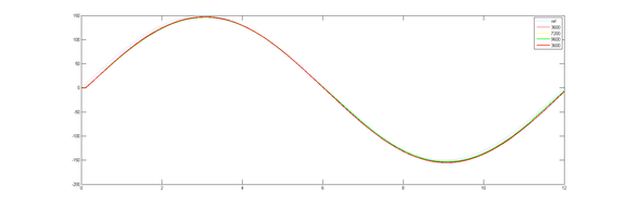

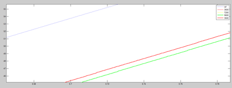

Implementing this code makes the result like figure as follow.
Plot blue is the reference. And Red and Green are encoder values in different mechanical conditions.
The delay that I mentioned is the gap between reference and encoder sensing value.
I want to delete this gap...   This delay is not dynamic delay. It is just from the code problem.
