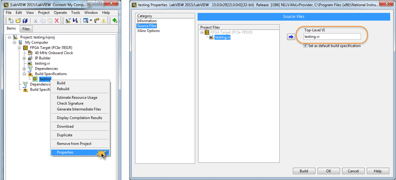

Just to expand on Hoovahh's response a bit ...
The FPGA context currently only allows one VI to represent the image for the entire FPGA. That VI is determined by the Build Specification. You can see which VI is selected as Top-Level in the Build Specification's Properties page.
