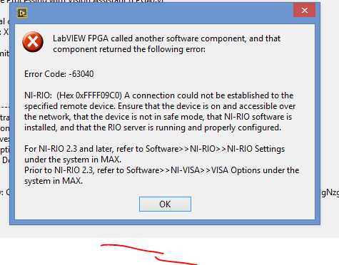

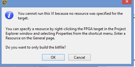

Hi there, I tried plug in my C920 HD Pro Webcam onto the myrio USB, and I open the demo project trying to run it. However, it showed error that the fpga target VI  need to be compiled first, but i failed to compile it. The errors are as in the attachment.
I am trying to use myRio FPGA to do image processing such as template matching function in OpenCV in hoping that the processing speed can be better than a processor and raspberry pie.

Hello Ada678,
check out this link: http://digital.ni.com/public.nsf/allkb/B77CEB8067558F6F86257203007F1E91?OpenDocument
I think it could help you.
