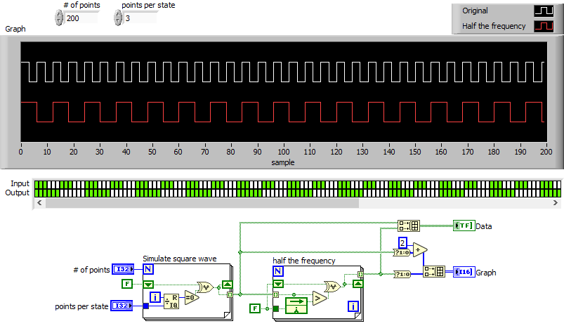

See if this can give you some ideas....

Thank you Altenbach!

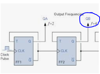

Indeed you understood it correctly what I wan to say. Kindly find VI and the circuit of frequency divider attached below.
Yes, I am totally new to Labview, there are a lot of things I need to understand that´s why I am making a lot of mistakes. Trying to learn it from youtube videos. But as I have an urgent task to do this that´s why I need help with that task (submitting by tomorrow). First I want to simulate it in VI and then I will acquire a signal from the signal generator using NI DAQ and then I will divide that acquired signal frequency in Labview.
But the first task is Labview simulation, and you have attached the exact output. Can you please provide VI for this too? the frequency division should be by 4. i.e. f/4

As we said, LabVIEW is a programming language, not a circuit simulator (such as e.g. multisim).
My VI is very simple flat code with everything visible. If you have trouble recreating it, you probably shouldn't even be on this project. Why would they ask you to submit this???
Then divide by two several times, just use another FOR loop!

Here's the code. Modify as needed. Never submit anything that you don't understand in the smallest details!
(Of course it would be interesting to rewrite it as a ptbypt VI that takes a scalar boolean input and outputs a scalar boolean at 1/4 of the frequency when called repeatedly with new values. Not shown.)
