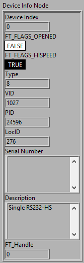

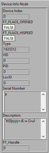

With remote debugging I probed the results of the API calls. In the init subVI I first call FT_CreateDeviceInfoList to let the driver create a list of all connected FTDI devices.
The result of this function is status 0 (FT_OK) and 'Number of Devices' is 1. Next I call FT_GetDeviceInfoDetail to get detailed information of the device with index 0.
The result is different when I run the program as a normal user...
Details - normal user
...compared to when I run it as an administrator:
Details - admin user
