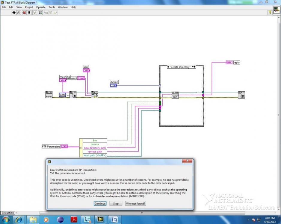

I have a couple ideas about that.
Firstly, your syntax should probably look something like the following:
post-15324-0-89154900-1369910270_thumb.j
Also, I suggest testing your VI with constants to make sure that your syntax is correct. Try finding a simple example that works and then building on that.
