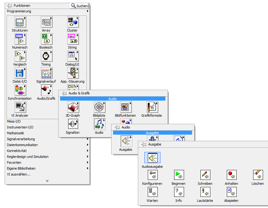

Hi Anastasia,
did you notice this function palette:
(German LabVIEW version, "Lautstärke" = "volume"…)
