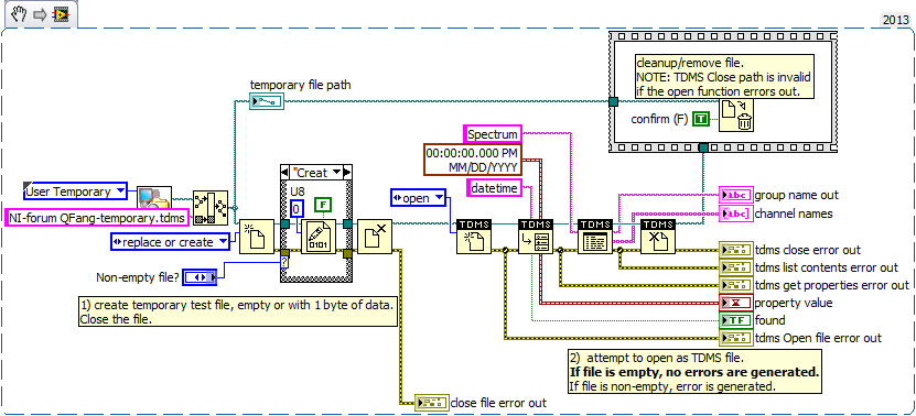

I found that if you 'open' an empty (0 byte) file using TDMS open, you will not get any error messages when you open it, nor when you call functions such as "Get properties" or "List content", also no error when you close the TDMS file.
If the file is non-empty, but not a valid TDMS file, TDMS open returns an error.
I would have expected that I would get an error or a warning at least when trying to read a non-existant property or group, if not by the open function itself?!
The 2013 snippet below creates a 1-byte or empty file in the local user temporary folder, closes the file, then attempts to open and read it as a TDMS file.  The temporary file is deleted afterwards.
If the file is empty, NO errors or warnings occur at any point.  If the file is not empty, it fails on the TDMS open. (Note the sequence structure is because the path out of the tdms close is invalid if the tdms open failed.
This could conceivably cause an issue if your program does not do additional fault checking to catch existing but empty files.  (Which of course shouldn't ever happen, but in some situations it could happen.)

Actually, TDMS Open allows an empty .tdms file of 0 byte if your open option is one of the following four options: "open", "open or create", "create or replace", "create", because TDMS recognize the 0 byte file as a valid .tdms file format and it will write some TDMS header information into the empty file to make it a real TDMS file. (You may notice that file size isn't zero byte after running your VI)
I would recommend a quick way to detect 0 byte file, you can use just the "TDMS Open" function followed by "TDMS Close" immediately, with the "open (read-only)" option wired to the open function, then the open function will return error as you expected, because the open(read-only) mode doesn't allow empty .tdms file.

Okay, I'll accept that for the "open tdms" function, that opening a 0 byte file is (in some cases) 'valid'.  Could you comment on why there are no errors or warnings when attempting to list a group that does not exist?
Hi thoult,
Yes there are plenty of ways to check for a 0 byte file before or after, I'm more questioning why this is not apparant from e.g. reading from an empty file?  It seems like one of those things that you wouldn't think that you needed to test for 0 byte files, if the file 'opens' you should be able to expect it is valid (thanks to Tianbin_Xu it seems it is in this case), and furthermore, if I try to list a group (e.g. Spectrum) and I get '0' I feel that implies the group exist, but there are 0 channels in it, without ambiguity of if the group even exist.   (Did you know that getting the file-properties, such as size, on a cRIO can take 10's to 100's of ms to complete if the file you inspect is particularily large and/or it is in an 'overpopulated folder'?)
All that said, this behavior was unexpected to me, but I've coded around it, the issue wasn't necessarily 'hard to deal with' once you know about it, it was just rather unexpected meaning I am now doing non-obvious extra steps that only makes sense once you know about this 'feature'.
