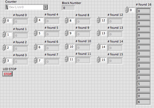

Why not simply expand the # found array indicator to display 16 elements rather than making 16 copies of the data?
Lynn
Message 6 of 14
(5,392 Views)

Good idea, I didn't know that was an option! Have only been using the program for a week, so I am still picking things up 🙂
