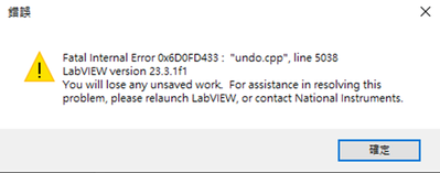

Hello everyone,
I am using LabVIEW 2023 Q3 . I get posted error.
Fatal Internal Error 0x6D0FD433 : "undo.cpp", line 5038
Please help me how to resolve this error.
Any insights or suggestions would be greatly appreciated. Thank you!

I think I read somewhere that you should set the LabVIEW undo limit to 15 or so because of crashes like this.  Unfortunately, I think you're going to have to let LabVIEW crash and lose your work this time around.

How many times has this happened?
If this was just one time?  Sorry, but you just have to recreate any lost work, if it wasn't caught by the auto-save.
Does this happen often but not in a way that's something you can re-create on demand?  If so, it could be that there's a VI or a NI file that's corrupt that you're working with.  You could try a repair or reinstall of LabVIEW.
Or does it happen every time you do a specific sequence of actions on a file?  Post the file and a set of instructions to replicate the problem so we can try it out and see if it is repeatable.

Add the following to your LabVIEW.ini file:
debugging=True
LVdebugKeys=True
DPrintfLogging=True
The next time the crash happens, check one of these log files:
%temp%\LabVIEW_[bitness]_[version]_[user]_cur.txt
%temp%\LabVIEW_[bitness]_[version]_[user]_log.txt
Hopefully the last entry in the log will point to whatever VI is causing the crash. You might have a VI with some insane objects or other corruptions that you'll need to address... and if the VI isn't loadable, you may need to restore it from a backup or recreate it.
I don't think the undo limit has anything to do with this crash, and I don't recommend changing it. You shouldn't have any problems with the default value of '99'.
