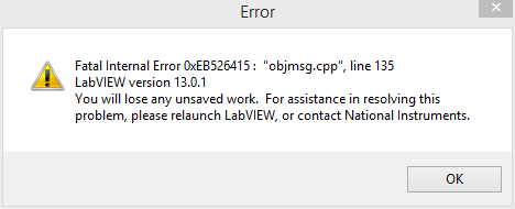

Fatal Internal Error 0xEB526415: "objmsg.cpp"
I've got a strange Fatal Error that i can't seem to overcome.  I don't know what would be causing it.  I've tried to narrow it down to a single file or labview object, but i can't really trouble shoot my labview classes b/c they won't load without causing the error.  I've manually deleted my object cache and tried to reload the project but that doesn’t help.  Mass compiling the project is also causing the fatal error.
I'm currently using Git for my version control and i have loaded different commits, but that does not seem to solve the problem.  I have no idea what to try next short of completely re-installing labview, although i don't see how that will help since other project/files are opening correctly.  Its a very strange error, b/c if i load another branch, the error seems to go away and it uses the same classes that fail otherwise.   Unfortunately my master branch appears to be the corrupt one and the two branches differ since the working one is a prior release.
Any thoughts on something to try would be very much appreciated.
Update:  I seem to have fixed this error, although i have no idea how.  I switched branches and loaded the other release another time and it seemed to clear up the issue.  I still think it had something to do with a corrupt file somewhere outside my project directory but not sure where.

How big is your project (how many classes/VIs)?
(3,596 Views)
Not a ton, probably 600 or so if fully loaded
(3,583 Views)
Do you have any crash report from this (should be in LabVIEW Data\LVInternalReports\LabVIEW\<LVVersion> folder)?
