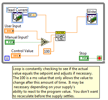

I would create a subVI that acts as a PID function (if you don't have access to the PID addon).  Basically this subVI would have a process variable input (which is the DAQ value that is read from your device) and a setpoint input value.  Inside this subVI is where you will scale the values and calculate a new setpoint based on the current value.   Something similar to the image below....what goes in the PID VI is up to you.  You'll want to put the code that clamps your program value to +/-1% in this subVI.
