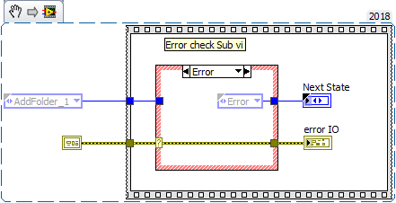

When you press the Stop button i suppose you want to go to the Stop Server-state. 🙂
Also, since you always go to error you can make a sub-vi that checks that instead of all the Select nodes.

Would you please elaborate on how exactly that error-handling-subvi is working? I don't think that I understand what you mean... Is it something like "IF an error occurs, pass it to SubVi and determine, in which case the error occured"?
(2,386 Views)
Yes, it sounds about right. Something like this:

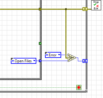

Well without all the sub-vi's I can't run it but at first glace I would say...
  1. Add Folder 1 and add Folder Status look similar enough they could might be able to be worked into the same State
  2. As for your error Handling
    1. Use the Error Cluster "Status" to put the error message in instead of carrying it around with another shift register (Also look into custom error codes)
    2. I like to do this so every state does not need redundant code
Now an error in any state will override the next state and go to the error state
Also you don't need to unbundle the Status Boolean from the Error Cluster
Instead of this:
Just do this:
The Error Cluster is "special" that way.
Oops I meant use the "source" part of the Error Cluster to put your error messages in.
With custom error codes you don't even need to do that in every state of your state machine. You can put the custom error messages in the "General Error Handler".vi., which by the way you should be using in your Error state to display your error message.
