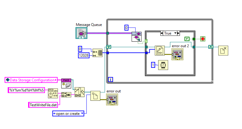

I'm trying to stream data to disk on a cRIO 9034 but I'm running into difficulties with what appears to be a memory leak when writing data. As I'm writing data to file, free physical memory decreases at the same rate that I'm writing data. The memory does not return after closing the file reference, even when using the Flush File vi. Every time I start a new file memory continues to deplete until I hit a floor when either file write speeds slow to a crawl or file write operations stop working entirely. The memory does not return until I either reboot the cRIO or delete the files from disk.
Below is some test code I'm using to replicate the problem. I am using LabVIEW 2017 SP1. This post seems to have the same problem and they said that upgrading to LabVIEW 2019 fixed the problem, however none of the release notes I can find for 2019 or other newer version of LabVIEW mention anything about fixing a memory leak problem. I would like to confirm that this is the most likely fix before I go through the process of upgrading.

In your image you don't "stream data to disk", but you write about 12kB of zeros to the file whenever the message queue has a certain condition.
The queue isn't read/emptied in your image!
There also is no "code" in your message, there is just an "image of parts of code"! How should we help you with an image?

I understand that this is just some testing code, but it is impossible to see the full picture (sic) from an image.
  • What is in the FALSE case and how often does each case execute?
  • Why is there a wait inside the case structure?
  • Why are there two error terminals, one deep inside structures.
  • Since the message queue is a terminal, I assume this is a SubVI? How does it get called? What is on the connector pane?
