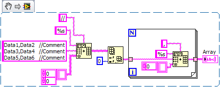

Hi Favas,
like this:
17655iBCF41A43A59A9403
There are other ways too for sure...
And yes, please indicate threads with more or less the same topic...
In the original thread you asked for the comment, now you ask for the data. You can get the comment by expanding the IndexArray function to get the 2nd column.
