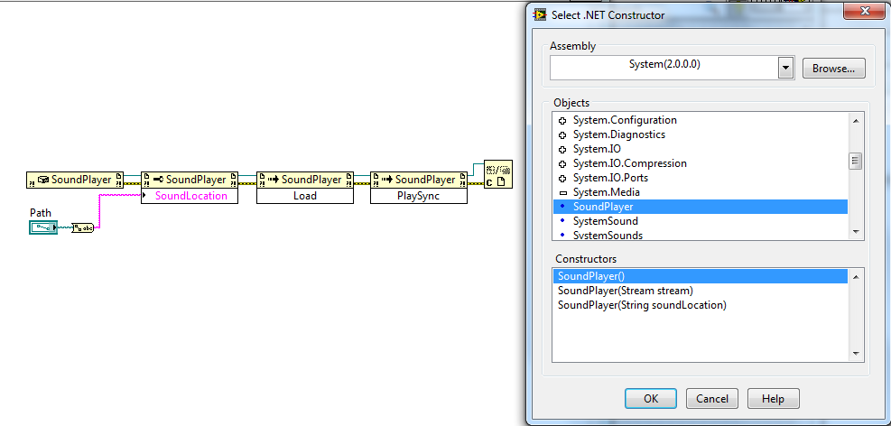

Try this.
/Y
Qestit Systems
Certified-LabVIEW-Developer
Message 9 of 20
(5,383 Views)
Ok, thanks, but now, How do you do to use "Media.setItemInfo"???????
