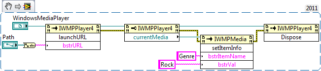

Then you can go with ActiveX all the way, just place a windows media player in an activeX frontpanel object similar to this:

My previous picture is a snippet, just save the picture to your computer and drag it into a VI.

Yamaeda, many thanks for you answer, but i have now two new errors.
1- The Dispose method not exist.
2- Changing the method i get other error.

What type of files are you altering? One reason the code is throwing an error is because the VI is unable to find the particular field.
A link to the method page is listed below and on that page is a list to the attributes defined for specific file types.
http://msdn.microsoft.com/en-us/library/windows/desktop/dd564910(v=vs.85).aspx
