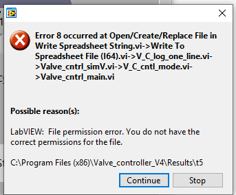

Running a new compiled version of my program (LV 2016) which appearred to be fine in testing.
However today it display these errors
this occurred at the write phase of the run followed by
This seems to indicate an issue with Windows 10 security. I have updated C drive security access to allow the application full rights (read/write etc).
I've also added the whole project so if the issue is mine please let me know.

Hi Greg,
there are file permission errors: the first check would be to make sure the file path you try to write to is correct!
Did you probe the file path?
You really should improve that program to use less global/local variables, more shift registers in your statemachine, avoid race conditions (like in ValveCntrlData), organize all VIs into the project, …

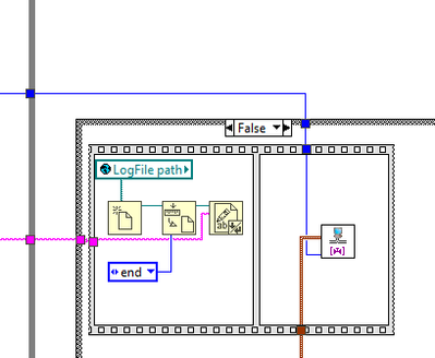

You specific problem is the following code:
Start reading here.

A probe is a basic troubleshooting technique in LabVIEW.  Right click the wire that contains your path and select "probe".  A window will appear that will show you its actual value during execution.
As the others have said, its a file permission error; here are a few options.
1) the file path is incorrect ( a probe helps check this here)
2) your trying to create a new file but you have "open" wired to the "operation" terminal of the open/create/replace file vi
          This requires that it already exists.  right-click the "operation" terminal and choose create constant.  you'll get an enum constant that you can change to "create/replace"
3) "C:\Valve_Controller_v4\Result" is a folder path, not a file so make sure you are including a file extension like .txt or .csv

Look in the main program, case "1". There is a subVI called V_C_log_initialize, this sets the global variable for the log file path to:
"<current VI path location (i.e. vi path stripped of the VI name)>/data"
Once it's inside the executable, the VI path is "... xxx/application.exe/vi name" and after stripping the name, you are trying to create a path as "...xxx/application.exe/data", which is of course nonsense. you cannot build a folder inside or after the exe!
Also, please give your data file an extension (e.g. call it "data.dat" or whatever). It's less likely to collide with a folder name (Often, there is a "data" folder next to the executable!)

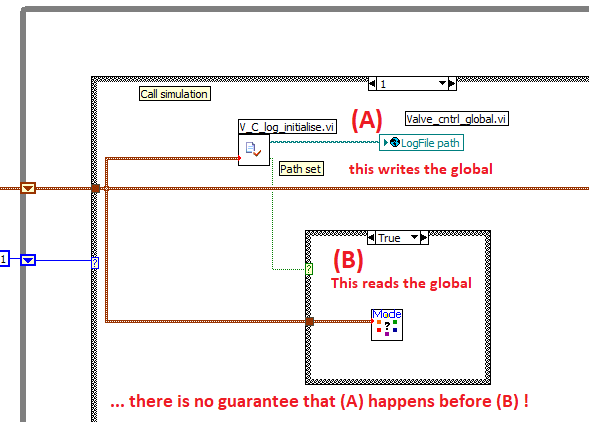

Also note that you have a potential race condition because you cannot guarantee that the global variable is written before it is read inside the subVI below.
Message 9 of 12

thanks.
I have worked out how to set the default install folder on my Win10 PC.
It appears that the Universities security policy was the cause of the issue. It would not let me write any data to the C:\program data  and C:\program data (x86) folders.
The security was set to Read only and the policy prevented the application from writing results to the folder.
Once I swapped to a specific folder (c:\valve_controller_v4) it was all good again.
thanks for your help, learnt more things today.
