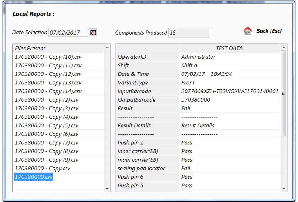

I am working on the a project to save the reports in CSV format for tests done, which is saved in respective 'date' folder (the date when test is done).
I want to have a display as shown in image below:Report window.JPG
I am not able to figure how to display the:
1. File Present Panel: To display all the csv file present in a particular folder.
2. Test Data Panel: The CSV data contents on clicking on a particular file.
Since, I am new to LabVIEW would appreciate your help.
Thanks.....

Hi Kunal,
1. Use a Listbox to display the filenames of the files found in your datafile folder. (Did you already notice that ListFolder function?)
2. Use a Table to display the content of the file selected in the listbox.
What have you tried? Where are you stuck?

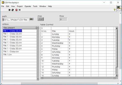

Thanks GerdW,
I tried using ActiveX controls, to use excel application type display to show the report file contents, but was getting too complicated.
For the listing the files saved, I was looking for file explorer type display, didn't knew about List Folder.vi.
