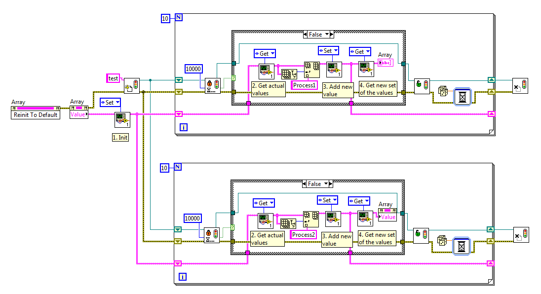

Yes, sure.
The code I attached I think is overcomplicated now. I've finished with semaphores anyway.

The first thing i notice that the result of the array will be the data from one loop or that from the other, never that of both.
Both loops work with a local copy of the array and you copy that local variable in the array.
You can try to load the variabele from a reference inside the loop ( watch out do this inside the semafore )
 That is false statement. Run the code attached and you see that the array consists of the data generated from both loops
Yes, it doesn't seem to be eficient way is it?
I don't understand your last statement.

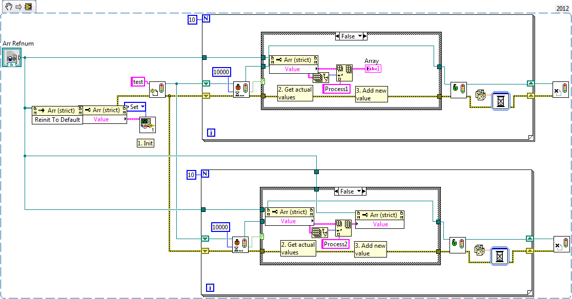

Sorry that is becose i dit not check the sub vi. was not at a system with labview at the time.
the last statement was with the first statement in mind it is not important at this moment.
the code below seems to be doing the same. and looks more clean
