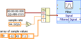

The Filter Express VI takes Dynamic Data Type (DDT) or Waveform Data Type (WDT) signal(s) as input. The following screenshot shows how it works when using a WDT. As you can see there are three components needed to build a WDT, these are:
  •  timestamp: the time of your first data sample. Optional but critical if you are running your filter in a loop (multiple consecutive WDTs)
  • dt: The sample interval that is the time difference between two consecutive samples. This is also the inverse of your sample rate and how you tell the Express VI about your sample rate. If you don't specify this value your Express VI will assume you were sampling at 1 S/s.
  • Y: The actual data array assumed sampled with dt interval
Check out the help for WDT or DDT for more information on how to correctly manipulate your signals.
