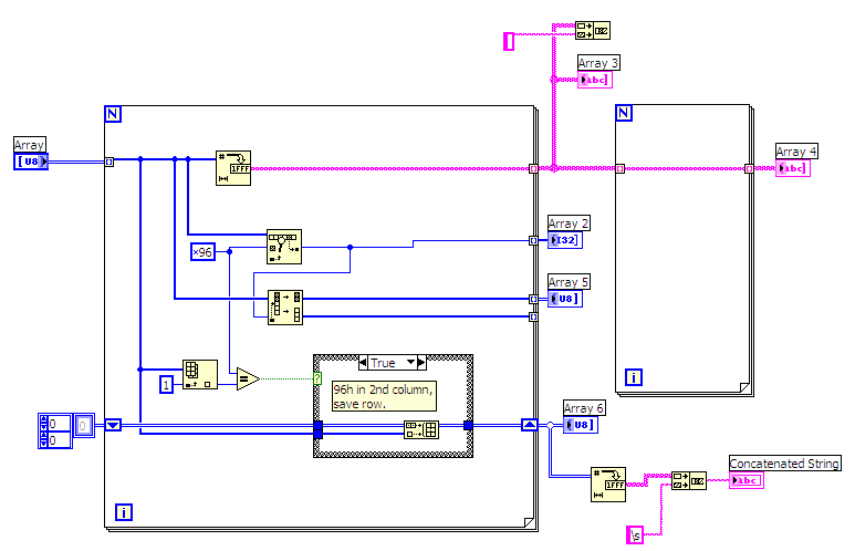

the problem I have is to filter a row from a 2D-Array. The datas which are read out are 8 byte each row. The first byte of a column is always 81h the other values are different. Now, when there is a 96h in the second column only this row sould be given out, string or 1D-array. In the attachment are some experiments. Hope anybody can help.

A shift register and a case stucture will do the job, if I understood correctly what you want to do. Note that using a Build Array node in this manner is not memory efficient for large arrays. Pre-allocating an array and using Replace Array Subset is better, but this is easy to follow and will work fine for small arrays.

Can somebody convert this VI to LV6.0 or make a screenshot of this VI? I forgot to tell, that I have only LV6.0.

Sorry I can't save to LV6.... here is a screen-shot of Lynn's VI 😉

Thanks Lynn and TiTou!
@Lynn: That is what I wanted.
