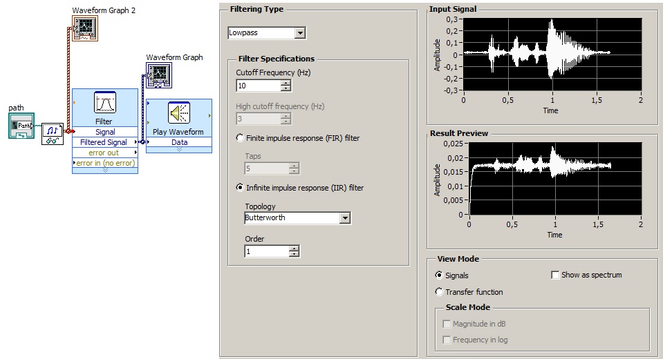

Hello, thank you.
I have tried to use scheme and settings as on picutre. File that I use is speech signal. So when I will set lowpass (below 100 hertz) I should hear no voice. But when I run this program the output signal sound like input but more silent.
Am I missing something?

Hi 5 times TOM,
you set a 1st order low pass, so it damps high frequencies with just 20dB/decade. It will NOT clear anything over 10Hz, it will just damp it!
You need to use a higher order for your lowpass filter to effectively cancel higher frequencies!
