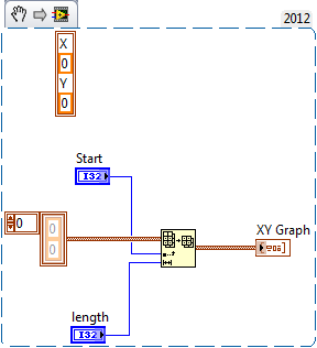

What is the structure of your data ?
If you have just pure x + y struct and the time is determined by the index of the element, you can use array functions.
If your data has bundled time info, all you need is to search the array for start index and an end

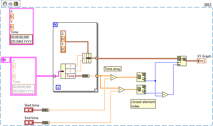

@KaungPyae wrote:
It's a string data created using Get/Time function and insert it into the Data Base.
Now i want the user to select from which time period to which period and only this filtered part will be shown on the graph.
thanks Bublina! 😄
This is basically what the 2nd code I posted does.
