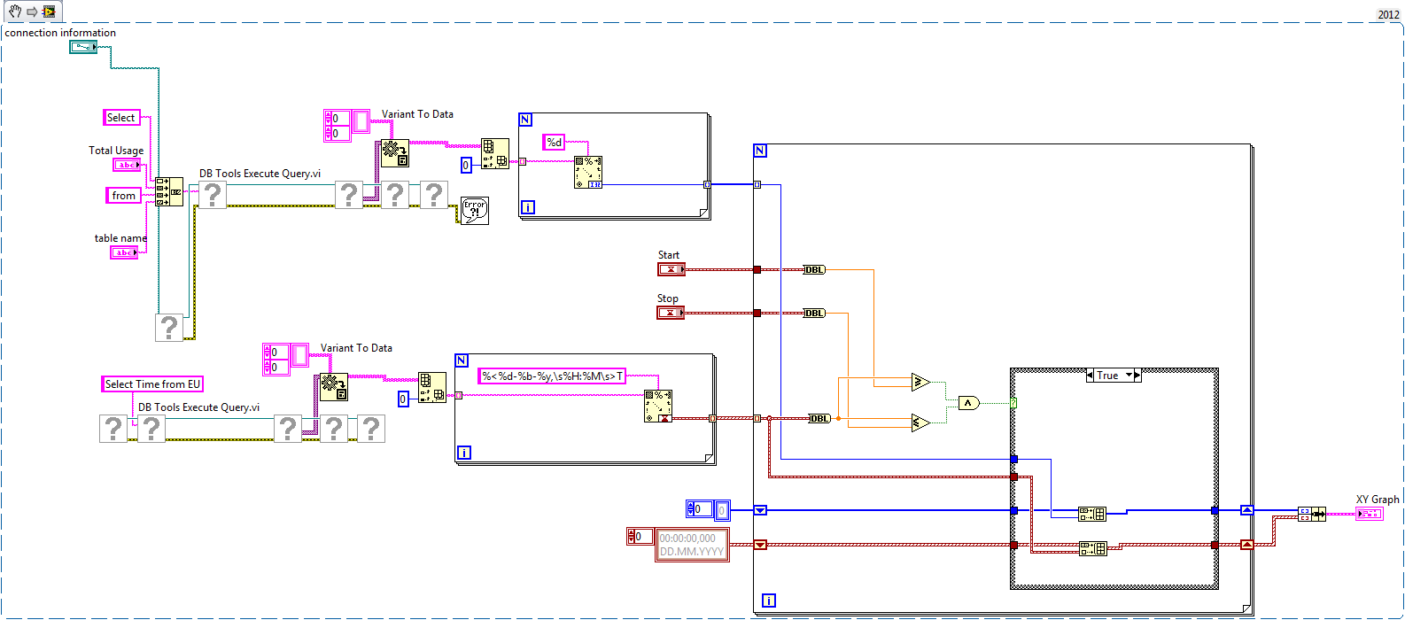

Try something like this:
If you have LV2K12 you can replace the case with autoindexing conditional tunnel that would make it faster.
Also, this will behave poorly for large data sets, if your data is aligned in time, you can search the data much faster.
