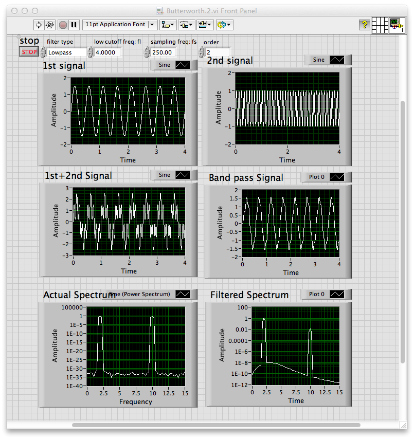

I have been trying to use Butterworth as a lowpass filter to limit the frequanies of my signal. I have provided the attached code in which two simple sine waves with 2Hz and 10Hz frequencies have been added. I have used low pass Butterworth filter with 4Hz as low cut of frequency. I expected to have the sine signal with frequency=2Hz (2<4<10) but the output of the filter (and also its FFT) is a very ugly!! and weird signal. Would anyone please help me to figure out where my mistake is and how to solve this problem?

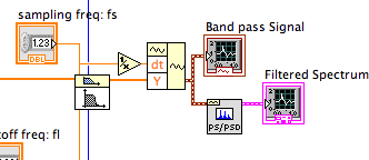

Soran,
The default values on your controls do not match the settings of the SImulate Signal VIs, specifically the sampling rate. When I set the sampling freq control to 250, everything seems fine.
Creating a waveform to tell the second FFT Power Spectrum VI about the timing information will give suitably scaled graphs for the filtered signals. Note that Spectrum Y-axes are set to logarithmic mapping in the image below.
Lynn
