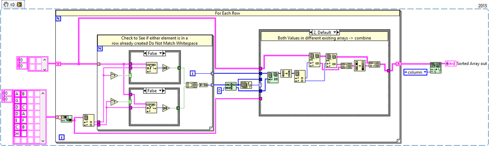

I am using the open G toolkit and currently, I have this solution:
As this is a fairly critical vi I would appreciate a review to:
  1. Make sure I didn't miss an edge case (It is safe to assume that the input array will always be NX2 and 'A' = '\sA'='A\s')
  2. Suggest any changes I could make to improve the Vi's scope or efficiency.

Sorry, I don't have any OGTK installed, so I cannot run your example. I would think a variant attribute based solution might be simpler. Have you tried?

Accepted by topic author ATE-EGNE
See if this works for you. 🙂 (No guarantees. Can probably be further simplified).

The following "breaks" your output (though the algorithm seems to work, it's just the Output that is strange) -- add another pair, (A, E), to your Input Array.  Before running this, predict the output (you'll probably be wrong).

I meant the Original Poster.  I understood the format for output was strings (arrays?) listing the "connected elements", with possibly spaces at the end.  By adding an additional input element that resulted in "merging" two strings, I ended up with an output that seemed to be in the "wrong" format.  Since the Point of the Exercise, I thought, was to have a nice algorithm that worked, rather than try to show that there were no "edge cases" that the OP missed (which is hard, in general), I demonstrated (I thought) the existence of an Edge Case, proving his algorithm was faulty.  Unless I downloaded it wrong ...  or my version of LabVIEW isn't working.

You are correct! I think I'll try to fix this, but I'll end up going with @altenbach's solution. I did not know you could do that kind of grouping.

I didn't even know you could do this! Also, if I'm not mistaken this vi would work for an N1xN2 array as long as N2max was known at compile time.
I'd be interested to know if this could be optimized further and debugged. I think I would like to use this logic as it seems to be faster and more versatile.

That's an interesting problem, fortunately for me, being connected is a boolean operation. the comment about the breakage was due to the fact that adding
{'A','E'}
at the end would produce
{'','','A','B','C','D','E','F'}
 Giving me two phantom connection points
