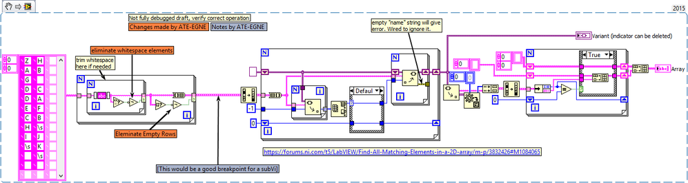

Ok, After playing with it to try and simplify the code, I found a few edge cases.
Here is what I have currently:
Please let me know what you think
So your changes mostly deal with new input specifications by allowing e.g. empty strings and empty rows. 😄
The first innermost conditional tunnel is pointless, because the "array to cluster" again pads it to 2 elements anyway before throwing the row away in the outer loop. Instead of the inner conditional tunnel, you could just auto-index the boolean followed by "AND array elements" to trigger the outer conditional tunnel accordingly. I am not sure if all that data massaging is really necessary, because the variant will reject empty strings (as names) anyway, probably with little speed penalty.
In terms of optimization, I think you could get rid of most prep work and initial sorting by making the code near the first case structure a bit more intelligent, depending on if both elements are unseen or only one is. Also, if an element already exists, we don't need to write it back to the variant, same for empty strings.
Also, the parts after the variant processing could probably be optimized, again probably at the cost of more code.
I intentionally kept everything simple and readable. 😄

@altenbach The first innermost conditional tunnel is pointless, because the "array to cluster" again pads it to 2 elements anyway before throwing the row away in the outer loop. Instead of the inner conditional tunnel, you could just auto-index the boolean followed by "AND array elements" to trigger the outer conditional tunnel accordingly. I am not sure if all that data massaging is really necessary, because the variant will reject empty strings (as names) anyway, probably with little speed penalty.
I found that with an empty row or a row of {'','\s'} would produce a blank row in the output column
@altenbach In terms of optimization, I think you could get rid of most prep work and initial sorting by making the code near the first case structure a bit more intelligent, depending on if both elements are unseen or only one is. Also, if an element already exists, we don't need to write it back to the variant, same for empty strings.
Ok, I'll go ahead and try and make some improvements there. Thanks a ton for getting me started!
Thanks for that! This type of sorting is new to me so I'll take a crack at improving it further.
