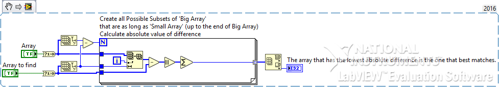

The solution in #9 will work if you have an exact match.
If there is a chance the match is not exact, this will work:
Message 13 of 17
(2,360 Views)
