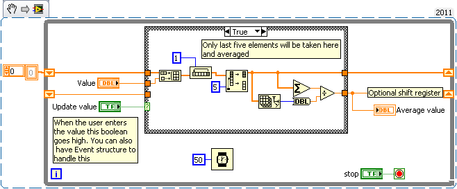

You can also use the arrays to hold the data in a shift register and find the average value of the last five elements.
Good luck

Why do you need the "while loop", and the "wait" function?
Is it possible to do without these?
Message 4 of 10
(5,789 Views)
You can do without that but for using the above example you need to have the shift register in place. If you don't want to run continously keep the while loop and connect the stop terminal to True and remove the initalization part before the loop.

Hi P Anand,
With regard to your solution, I have a few question:
- what is the size of the array constant? Does it have to be initialized?
- if I keep entering numbers, will there be a limit to the size of the array?
Message 6 of 10
(5,761 Views)
No if you want to use this as a sub vi you leave the shift register uninitialized.
If you want to limit the array size you need to use Replace array subset or Delete From array functions.

Just curious...
- how to reset the 1st subarray of the "Split 1D array" to all zeros? Just in case I want to clear the buffer elements to all zero
- how to reset the output of the "Build array"?
Good luck
