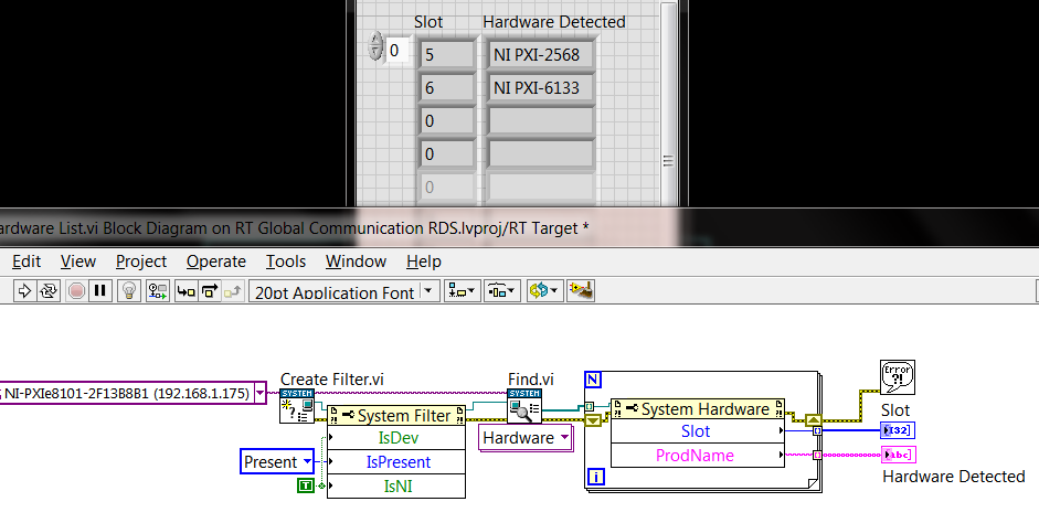

Cory, can you use something like the code below on cDAQ? With this code, I have found two devices on slots 5 and 6.
As far as the channels being live or empty, I would just ping each channel for data real quick when I start. An open (non-existant) strain gauge should be easy to detect. Make an array of "active" channels that way. Smiley Happy

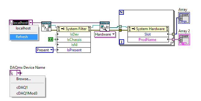

Hmm for some reason it won't populate the cDAQ device in the "session in" I/O constant.
It only populates the list if I place a DAQmx Device Name constant, as shown in the bottom of the code.

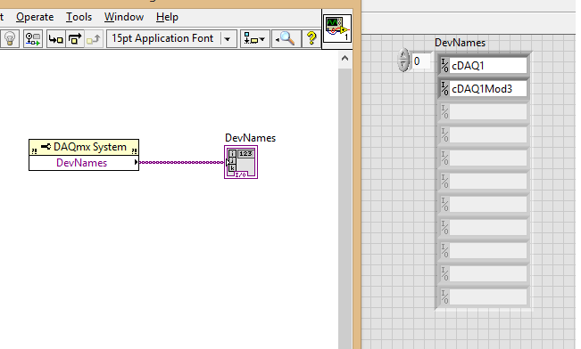

The only way I have been able to programatically determine the devices is the following:
I guess I can use a simple regex to grab anything called cDAQ1Mod*

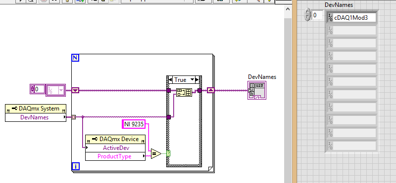

Alright, I used the following code to generate an array of all of the modules that are present.
Now I just have to figure out how to create a task on the fly.
I think when I was watching the device in MAX, any channel that has a gage gives a reasonable reading.
Any channel that is empty just gives a maxed out value (such as 59,000 microstrain).
So once I find a module, I can just check every channel to see if it's value is above some threshold, like 10,000 microstrain.

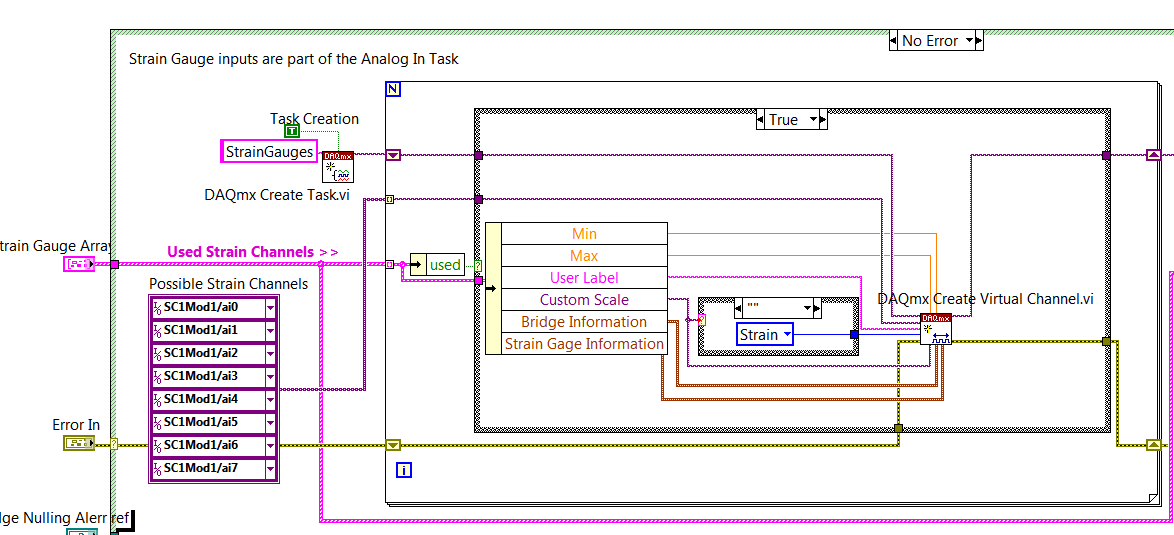

So with each new start of the program, you'll have a known device (your strain gauge device), but unknown channels. Here's the way I attacked that a few years ago...
  • Use DAQmx Create Task to create a task.
  • Make an array constant of all known possible channels. Say this is 8 elements, and compare that to an array of USED channels, making phony channels out of the "Not Used" channels, and real channel names out of the Used ones. Conditionally check which ones are used to pick off the correct channel, and add DAQmx Virtual Channels appropriately. The VI snapshot below goes into more detail. I brought in not only the used channels, put the channels properties as well, such as min/max and bridge info. My VI also performed bridge nulling, conditionally, depending which sensor the user wanted to null (that part is not shown.
This code is not super elegant, but I hope it gives you come ideas.
Richard

That looks like it should do the trick!
@Broken_Arrow wrote:
  • Say this is 8 elements, and compare that to an array of USED channels, making phony channels out of the "Not Used" channels, and real channel names out of the Used ones.
Can you elaborate on this a bit? Where did that array "Strain Gauge Array" come from? Did you create that cluster with all the gage properties?
Cory K
Message 6 of 10
(7,217 Views)
I didn't explain the "Not Used" channels very well. Notice the cluster unbundle called "Used?". Let's say the third channel is being indexed from the array constant. In the "Strain Gauge Array" there's a boolean that was turned to TRUE if the user is using that channel. I can tell the user is using the channel because they moved the selector from "Not Used" to an actual channel number.
Yes, the Strain Gauge Array is an array of clusters. The clusters have the channel name (or Not Used), and all the gauge properties. Your situation is a bit different - maybe similar enough to get *some* use out of the screenshot. Sorry for not posting the actual code - not allowed.
Richard
Message 7 of 10
(7,210 Views)
Oh, so you actually have toggle switches on the front panel that has the user tell you what they plugged in and where?

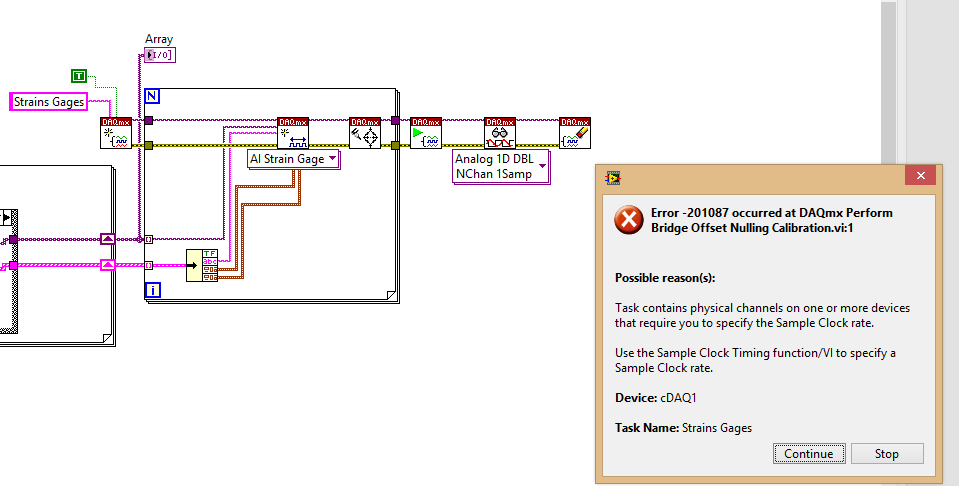

Alright I'm making slow but steady progress on this.
I seem to be stuck on the actual task of actually aquiring the measurements from the gages.
Ideally, I would like to acquire 1 sample per channel at a rate specificed by the user on the front panel.
However, for some reason it will not allow me to use "NChan 1Samp", it keeps telling me this
I have attached my code if someone wouldn't mind taking a look at it.
Cory K
Message 9 of 10
(7,186 Views)
Apparently I just need to do this really difficult thing called read the error message. Smiley Very Happy
I added a Sample Clock function and everything is working now.
Thanks again!
