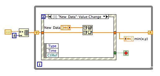

I have an array which changes its values every iteration and I want to compare the new values with the previous values and make a new array with the minimal values...
In C++ it would be like this:
int main(){
  int array[8];
  int min[8];
  int i;
  for(i=0;i<8;i++){
    min[i]=1000000;//Initialize minimun array with a high value
  while(1){
    array=update_array();
    for(i=0;i<8;i++){
      if(array[i]<min[i]){
        min[i]=array[i];
    //do stuff....
  return 0;
Im new to labview and it still confuses me a lot...
thanks in advance.

Use of the regular Max & Min function (not Array Max & min as you are aware) with arrays and a shift register will do job nicely.  Max & Min, like most numeric functions, is polymorphic and works witt arrays as well as scalars.
