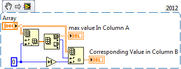

Use index array to get column A. Use the "Array Min & Max" function to get the minimum value in column A, and it will also return the corresponding index at which that minimum is found. Then, retrieve that same index from column B.
(2,872 Views)
Here's a visual representation of Nathan's example:
(2,857 Views)
