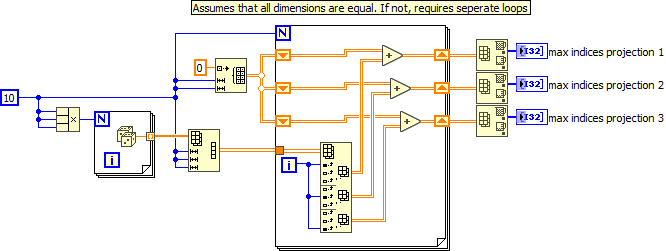

@altenbach wrote:
If you want the max in each projection (e.g. the column in each direction with the highest sum, not much more code is really needed.)
Here's how that could look like.

Hi alten
I dont understand whats happening in the example , it seems like the code retrieves the indices rather the maximum projection values? but i suppose i could also extract value rather than indices. I will try play with the code to understand whats happening in a test file. thanks for your help

"Array min&max" will also give you the max values. Just add an indicator. 😉
(terminal is right above the indices).
