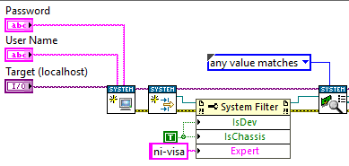

Use NI System Configuration API. It can be run on the host PC to query the resource in RT.
Refer to the shipping example Help >> Find Examples... >> Hardware Input and Output >> System Configuration >> Show All Hardware
Use ni-visa as the Experts for the System Configuration API Functions
