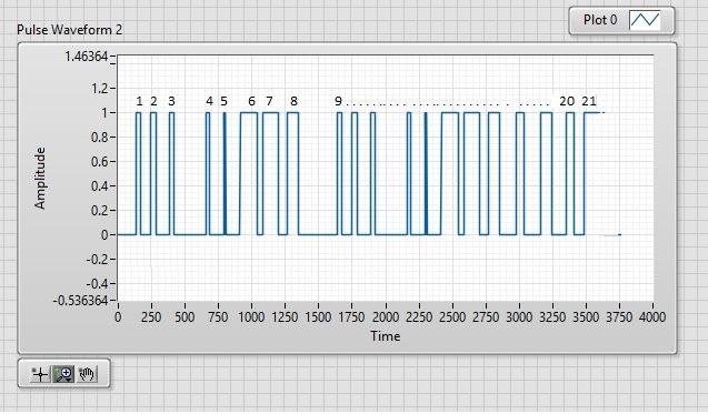

Consider an example, this pulse waveform contains some random repetitions of 0’s and 1's
Here the occurrences of value 1 is 21 times. So, how I can count this programmatically as No of 1's as 21
If I use Search function of array, just it display the corresponding y axis value of the First occurrences of 1.
How can I perform this operation???

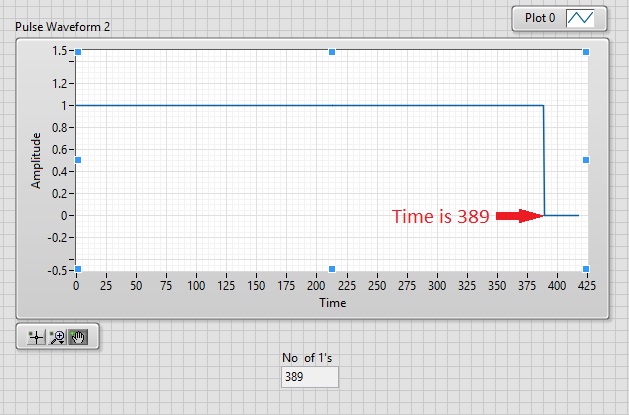

when I follow your code. Just it gives no of repetitions of 1 on the basis of X - axis value. If my pulse is continuously giving 1 from ( 0 - 389 in X axis )
It shows 389... But see above output picture there is no occurrence of 0 (from 0 to 389 in X axis ) right. so, my goal is to take that as one occurrence of value 1.. If my pulse again goes to higher state then count it as 2 till it falls to low state.
Can you getting my point.??

did you read my comment on using a rising-edge filter in message #2?
Did you even try to use that? Did you try to configure the mentioned Vi to detect falling edges?
(3,235 Views)
Thank you GerdW..
Now I got the point. Thanks a lot.
