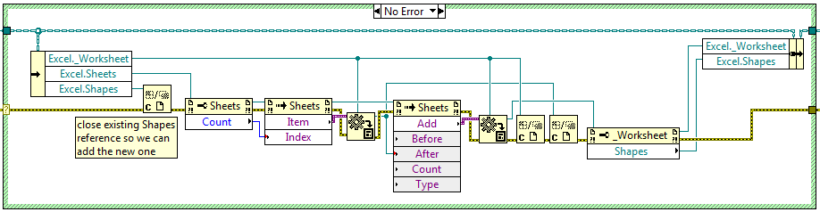

You need to use the ActiveX "copy" command on the Sheets object.  The image below is from the Report Generation toolkit for adding a new sheet to a workbook.  This needs to be modified to change the 'Add' method to 'Copy'.  You will then need to select the sheet index that you want to copy and tell the Copy method where to place the new sheet (Before or After).

Thanks for your reply.
I tried to do the same you have suggested. As the "Save As" option does not work, I tried to copy the block diagram into a new vi but it gives the error. I am attaching here the screen shot of the same.
(5,567 Views)
I am not sure how you extend the functionality of the Report toolkit.  I was suggesting that you use this code as a starting point for your own VI.  You will have to create the Excel references, open your workbook, copy the worksheet, etc.
