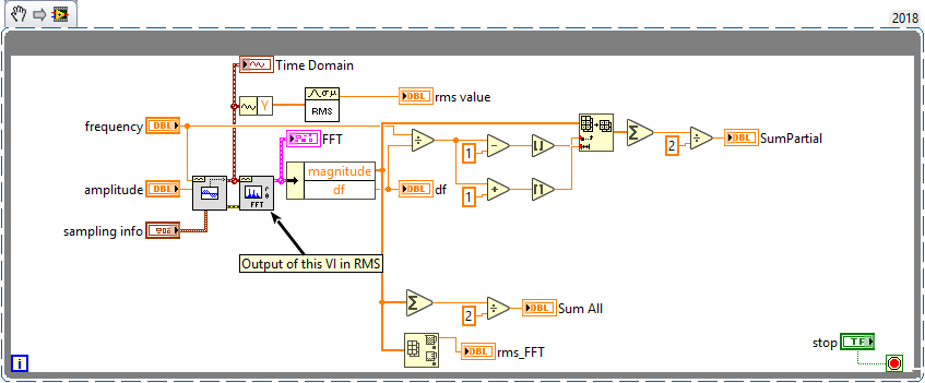

Please Find attached VI. Currently it has  only Sine wave generation and FFT Magnitude and Phase VI. Here all my parameter value like  frequency or  amplitude are simulation data. Sampling rate 100k and Sample to read 10k.
Once i am able to find energy in this distributed frequency band then i can integrate into my application (Frequency range 5-30 kHz) where Sine wave is a signal from my acceleration sensor.

You put the answer to your dilemma right on the Front Panel of your VI -- "Freq Resolution = 10 Hz".  The FFT estimates the component of the signal in 10 Hz bins, so you have some "signal" at 80 Hz, some at 90 Hz, some at 100 Hz, some at 110 Hz, some at 120 Hz.  The biggest peak will be at 110, which is closest to 105.1 Hz, but it's a "crude" estimate, so you can't expect it to be precise.
Suppose you sample 20,000 points at 1 kHz, for a resolution of 0.05 Hz.  Your FFT would be a single "sharp" peak, with magnitude of 0.7071 (which you might realize is sqrt(2)/2, the correct answer).
Nothing wrong with your code, you just don't know how/when to use an FFT.
Bob Schor

@Bob_Schor The biggest peak will be at 110, which is closest to 105.1 Hz, but it's a "crude" estimate, so you can't expect it to be precise.
I know that with this resolution i can not expect precise and Sharp peak  but in this scenario(with this sample rate and Number of sample) if i want to find Energy that distributed to near frequency(I have some "signal" at 80 Hz, some at 90 Hz, some at 100 Hz, some at 110 Hz, some at 120 Hz) which estimation is good whether taking Quadratic mean or just average that can give me magnitude near to 0,7071. That is the problem i am facing.
In this case my acquisition become slow and i read data or update graph  after every 20 Sec (Because 1k sample rate and 20k Sample to read). I am doing computation on fly so i want acquisition to be fast and once measurement taken, I shift to next frequency.

Because you don't have frequency bins that match your resolution, you get "leakage" into the other frequency bins. A crude way of determining the RMS is adding the whole spectra, note this is exact when you frequency falls into a bin. If you can deal with some uncertainty try summing around the peak in question.
