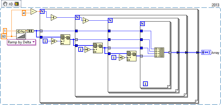

It seems easy enough to brute force. 🙂 If i'm correct the answer is 521800 combinations. (Hmm, I see a mistake now, let's see if you spot it)
/Y

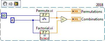

Why reinvent the wheel. You can always use the built in VIs
btw the answer is 487635

Counting the number of combinations and generating an array containing all possible combinations are two different things. Do you really need the output all at once or would it be sufficient to generate and process one at a time without having a hardcopy of all of them at the end?
In any case, definitely don't do this in SGL. As Yamaeda demonstrated, U8 is plenty to uniquely define the index of each of the 60 elements.  Personally, I would probably do it a bit differently, but I don't have time right now to look into it in more detail.
Can you explain the purpose of this exercise? Are all 60 elements unique or could there be duplicates?

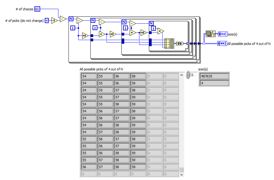

(Finally got off the bus and had a minute to show what I had in mind...)
Here is the "dumb" code that seem to also give 487635 possibilities in agreement with jamiva. No guarantees. Maybe it can be simplified?
Now "smarter" code would use a single loop and allow the number of picks to also be a variable input. Scalability is the key here!
Try it 😄

We'll, that's a different problem, so take your array of random values into the innermost loop and  use my four values to index out the four corresponding elements from the random array, add them, and feed them into ptbypt min&max. That's all. See how far you get. ( I am currently not at a computer).
