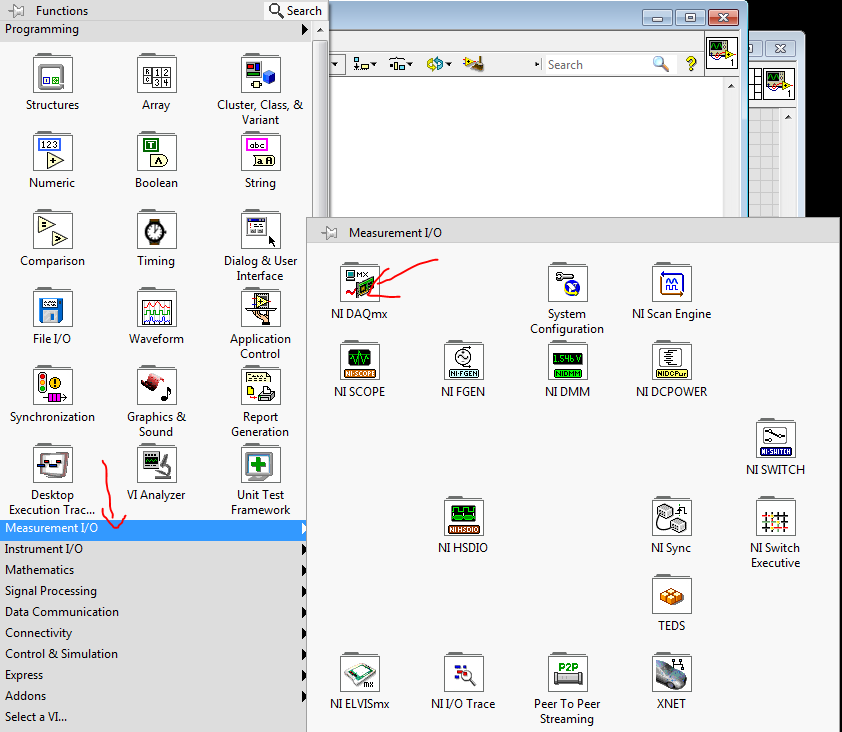

Hello CastleWorks,
you can find the DAQ assistant under the palette Measurement I/O -> DAQmx -> DAQ assistant

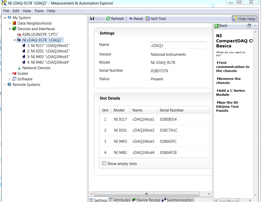

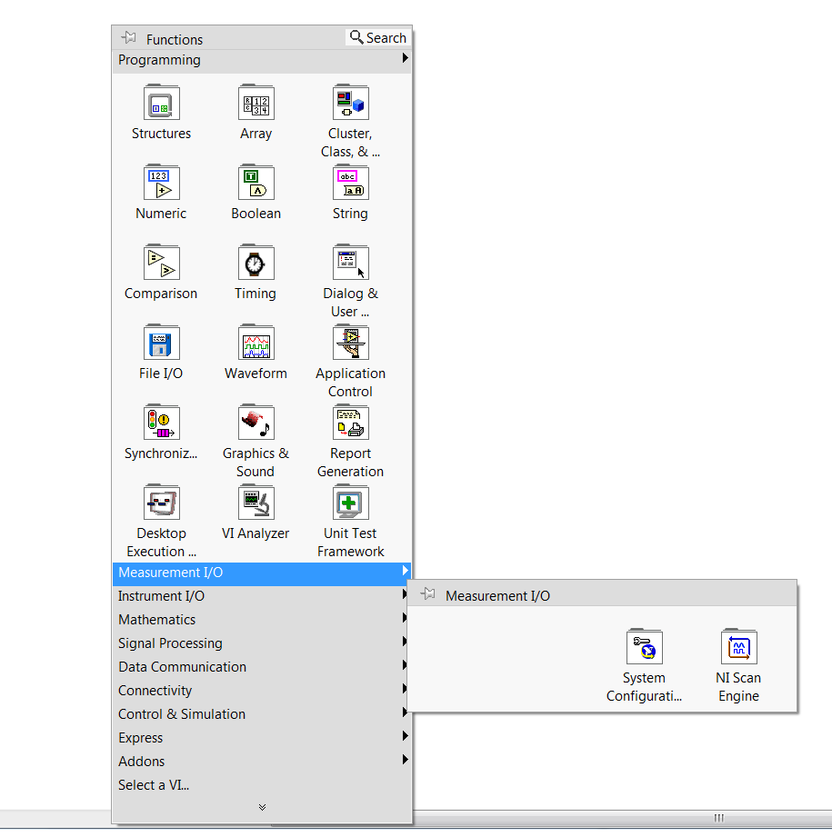

Hi Alexander,
That was my thought, they should show up under th Measurement I/O pallet....but I am not seeing them there. Is there a first step I need to do for LabView to recognize them? Here is a shot of NI Max as well.
(4,367 Views)
Accepted by topic author CastleWorks
Hello CastleWorks,
which LabVIEW version and DAQmx version is installed?
Reinstall or repair the driver could help.
NI-DAQmx 16.1
best regards
Alexander
(4,362 Views)
I reinstalled DAQmx and that fixed it. Thanks!
