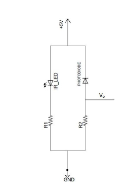

I am trying to aquire a PPG(photoplethmysography) signal through LIFA.It basically measures the relative blood volume changes using a IR photodiode and a IR led .setup.PNG.This is the circuit which I have made for aquiring.The V_0 is taken through the A0 input of the arduino.The VI which I am using is attached.

You need samples at twice the rate of your highest frequency to pull out the necessary information without aliasing. There are many ways to do what you want to do, but we need to see you .vi's to actually help. Save for LabVIEW 2013 for me specifically if you can.

I have uploaded the file,in the question.(ppg.vi)
