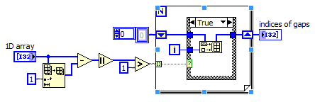

Hi kahlenberg,
I wonder If there is a labview function doing this. It seems there is not
There is a full palette of array functions. There are comparison functions. There are math functions.
So there are a lot of LabVIEW functions allowing you to do what you want to do!
You know this process is called PROGRAMMING!?
To give a hint:
(This is made with LV2009, with more recent versions you can use conditional tunnels…)
(4,713 Views)

Hi kahlenberg,
you were asking for a function, that should search for some "gaps" and split your array into smaller array parts. No, such a function does NOT exist.
But you can use several other functions to reach your goal. That was what I was teaching you…
And yes, you can even use Search1DArray for your task…
