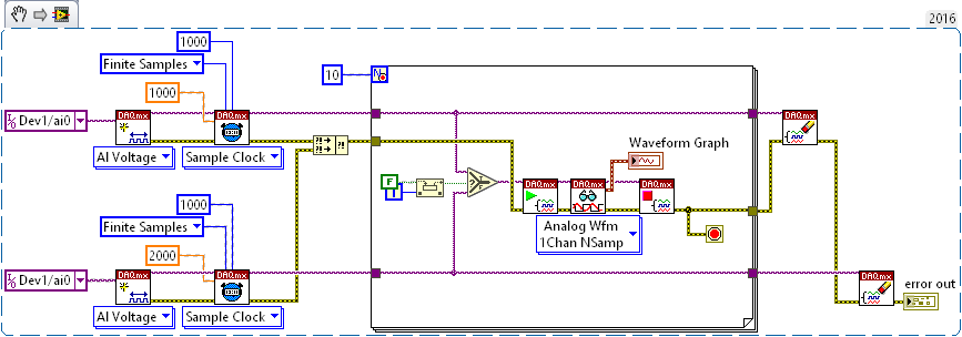

Nonetheless, below is a minimalist example of what I meant in #3.  Tested successfully on a desktop X-series board.  (The not-so-commonly-used little function in the loop is "Rotate Right with Carry".  I only use it to alternate F/T for even/odd numbers, and therefore alternate which of the 2 tasks is selected to start, run to completion, and stop on that particular loop iteration.)
-Kevin P
