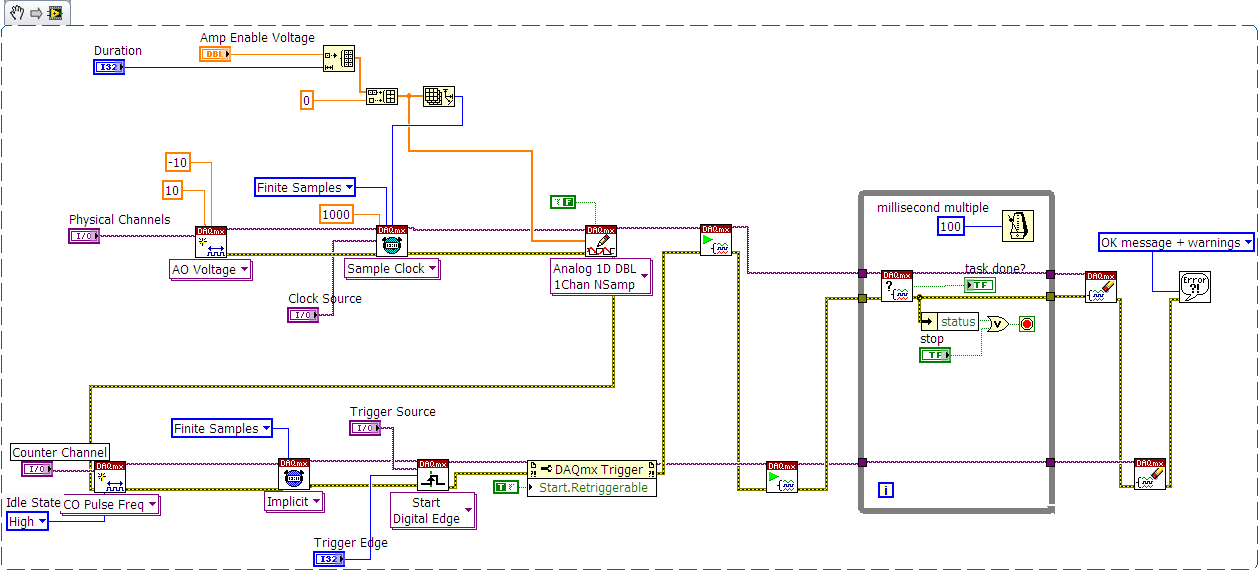

Not sure but here is an image anyway.
18971i6003EC9A6B78C405

@dave6k wrote:
I am now having trouble setting this up for retriggering. I have followed an example here. The difference is that I do not want to output a continous waveform, only a short sequence. I have attached the VI I am using. The triggering signal is a 50 Hz square wave. When I run the program, I get an output on one edge, but the rest are ignored. If I change the Clock sample mode to continuous, it does retrigger, but only very slowly (once every couple seconds). I am also concered that the "Task done?" output is reading true constantly after the first trigger.
There are some parameters that you have not set properly.  In the Counter Create Channel funciton, you did not wire in a frequency.  The default is 1Hz.  so that is why your retrigger is slow.  The way the counter works is that you set up a frequency for the pulse output, then set the timing for either continuous or for finite samples.  If you set for finite samples, then you also have to wire in the number of samples.  Every time the counter receives a trigger, it will output the number of samples specified at the frequency specified.  Until it is done, it will ignore any more triggers.  After it is done, it will look for the next trigger and do its output again.
So what are you wanting the counter to do?  How many pulses out per trigger event and at what frequency?  Are you wanting to output one pulse per trigger?  Why not use the trigger itself as an output instead of the counter?  Are you wanting to output so many pulses at a faster rate for every trigger?  Your frequency setting and number of samples should be faster than the incoming trigger.  For example, if the input trigger is 50 Hz, which is 20mS per trigger, you can send out 20 pulses at a 1KHz rate.  1KHz period is 1mS.  So 20 pulses times 1mS is 20mS.  Your period ( 1/freq) times your number of samples cannot be greater than the incoming trigger period.  In fact it should be less so that you don't miss a trigger.  With the default values, the counter will output 1000 pulses at 1 pulse per second.  You need to change these settings.  I hope this is clear.
I noticed in your loop that you are waiting until the stop button is pressed or an error occurs.  Should you not use the Task Done output to stop the loop also?  The way you have your code, the analog output will happen just one time.  It will output a certain number of samples and then the loop will wait until stop is pressed.  Is this what you really want to do?  Why wait until stop is pressed with the analog out being idle.  Well I guess the counter should continue until stop is pressed.

What I am trying to do is to output a pulse of varying duration (1-2 ms) on every rising or falling edge (depends on the situation) of the trigger. If the trigger is 50 Hz, there should be 50 pulses in a second. On the DAQ hardware I have, I cannot make a digital input "retriggerable", so that's why I am using the counter. I understand your point about the frequency, I have changed it and made it the same as the clock rate for the AO. It seems to be working, although I don't quite understand why the samples per channel on the counter has to be greater than the duration of the analog output. If I don't do this, the output looks aliased. For example, I set the duration to 2 ms and the samples per channel to 2.1 ms with a 50 Hz trigger and it is OK, but not if both are 2 ms.
