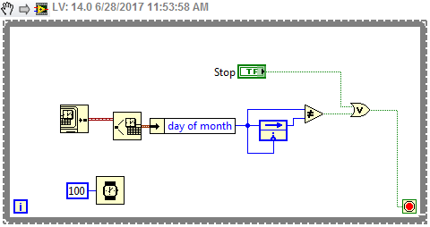

The easiest solution I've ever found to this was to look at the day, and in a shift register or feedback node, compare it to the previous value for day, and if it is not equal, then do your event.  If it is equal (then midnight hasn't passed) and you should not trigger the event.  If you move time zones this will effect it, but if daylight savings occurs it will still happen since that is at 2AM.
(6,568 Views)
Thank you for your replies and for the example. It seems pretty straight forward and simple. I knew there must be a simple solution, I was just over thinking the whole thing!!
